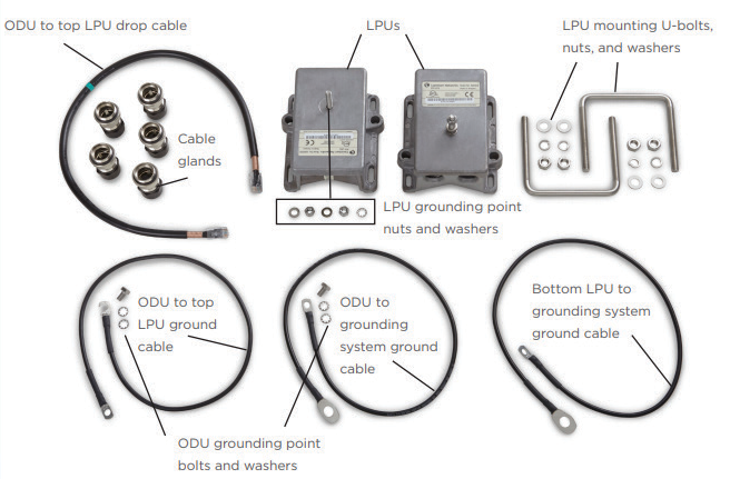

Lightning Protection Unit
Lightning strikes are the most typical cause of system outages or failures of mast-mounted equipment, especially when mounted as high as 300m.
The Cambium Networks Lightning Protection Unit designed for the PTP 650 Series are ruggedized to operate in the toughest environments.
