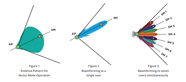

Beamforming
Intelligent Beamforming
Create narrow, targeted beams that improve signal performance while limiting interference in other directions.

  • Beamforming directs narrow radio beams toward individual subscribers.
  • Spatial multiplexing allows multiple beams to operate concurrently in the same spectrum.
