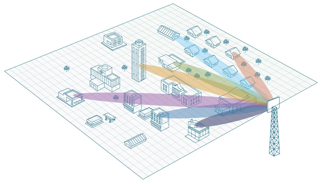

What can you do with 45 MHz of additional spectrum? With cnMedusa™ Massive Mu-MIMO technology in the PMP 450m, you can provide over 750 Mbps of capacity to up to 238 Subscribers in a single sector. Have a look at this thread on our community forum, describing several customer deployments and the real-world results they are having using PMP 450m. There are also a lot of technical details in our cnMedusa Solution Paper. With advanced Point-to-Multipoint (PMP) techniques like GPS Synchronization, Beamforming in both Uplink and Downlink directions and Massive Multi-User MIMO extremely high capacities and spectral efficiencies can be realized.
