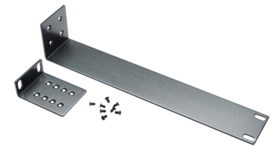

Rack Mount Kits
MX-EXTXFULLA-1
Rack mount ears for the EX1028 / EX2028 / EX2052 / EX2016M-P / TX2020R-P / TX2028RF-P family of Switches
MX-EXTXHALFA-0
Rack mount ears for the EX1010 / EX1010-P / EX2010 / EX2010-P Switches
MX-Rack-TX2K-0
Rack mount ears for the TX2012R-P Switch
MX-Rack-TX1K-0
Rack mount ears for the TX1012-P-AC / TX1012-P-DC Switches
MX-DIN-TX1K-0
DIN mount kit for the TX1012-P-AC / TX1012-P-DC Switches

Rack mount ears can be used for rack mounting or wall mounting as follows:
| Switch Model | Family | Port Configuration | Includes Rack mount ears | Part Number | |||||
| MX-EXTXHALFA-0 | MX-EXTXFULLA-1 | MX-Rack-TX2K-0 | MX-Rack-TX1K-0 (Black) |
MX-Rack-TX1K-1 (Grey) |
MX-DIN-TX1K-0 | ||||
| cnMatrix | EX1010 | Enterprise | 8 Port non PoE | No | 19″ Rack | Wall | NA | NA | NA | NA |
| cnMatrix | EX1010-P | Enterprise | 8 Port PoE | No | 19″ Rack | Wall | NA | NA | NA | NA |
| cnMatrix | EX1028 | Enterprise | 24 Port non PoE | Yes | NA | 19″ Rack or Wall | NA | NA | NA | NA |
| cnMatrix | EX1028-P | Enterprise | 24 Port PoE | Yes | NA | 19″ Rack or Wall | NA | NA | NA | NA |
| cnMatrix | EX2010 | Enterprise | 8 Port non PoE | No | 19″ Rack | Wall | NA | NA | NA | NA |
| cnMatrix | EX2010-P | Enterprise | 8 Port PoE | No | 19″ Rack | Wall | NA | NA | NA | NA |
| cnMatrix | EX2028 | Enterprise | 24 Port non PoE | Yes | NA | 19″ Rack or Wall | NA | NA | NA | NA |
| cnMatrix | EX2028-P | Enterprise | 24 Port PoE | Yes | NA | 19″ Rack or Wall | NA | NA | NA | NA |
| cnMatrix | EX2016M-P | Enterprise | 16 Port PoE – 6×2.5G | Yes | NA | 19″ Rack or Wall | NA | NA | NA | NA |
| cnMatrix | EX2052 | Enterprise | 48 Port Non PoE | Yes | NA | 19″ Rack or Wall | NA | NA | NA | NA |
| cnMatrix | EX2052-P | Enterprise | 48 Port PoE – fixed 520 | Yes | NA | 19″ Rack or Wall | NA | NA | NA | NA |
| cnMatrix | EX2052R-P | Enterprise | 48 Port PoE – CRPS | Yes | NA | 19″ Rack or Wall | NA | NA | NA | NA |
| cnMatrix | TX2012R-P | WISP/Tower | 8 Port PoE – CRPS | No | NA | Wall | 19″ Rack | NA | NA | NA |
| cnMatrix | TX2020R-P | WISP/Tower | 16 Port PoE – CRPS | Yes | NA | 19″ Rack or Wall | NA | NA | NA | NA |
| cnMatrix | TX2028RF-P | WISP/Tower | 16 Port PoE – CRPS | Yes | NA | 19″ Rack or Wall | NA | NA | NA | NA |
| cnMatrix | TX1012-P-AC | WISP/Tower | 8 Port PoE | No | NA | Wall | NA | 19″ Rack | 19″ Rack | DIN Rail Mount |
| cnMatrix | TX1012-P-DC | WISP/Tower | 8 Port PoE | No | NA | Wall | NA | 19″ Rack | 19″ Rack | DIN Rail Mount |
| cnMatrix | EX3028R-P | WISP/Tower | 24 Port PoE | Yes | NA | 19″ Rack or Wall | NA | NA | NA | NA |
| cnMatrix | EX3028R-P | WISP/Tower | 48 Port PoE | Yes | NA | 19″ Rack or Wall | NA | NA | NA | NA |
