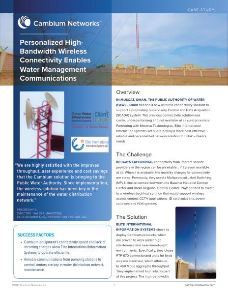

ELITE INTERNATIONAL INFORMATION SYSTEMS chose to deploy Cambium products, which are proven to work under high interference and near-line-of-sight environments. Specifically, they chose PTP 670 connectorized units for fixed
wireless backhaul, which offers up to 450 Mbps aggregate throughput. They implemented four links as part of this project. The high-bandwidth connectivity was chosen to support live SCADA communications to the Public Water Authority’s central control center from their regional control center.
Planning and deployment went smoothly. First, Elite International Information Systems conducted a detailed project feasibility study. Then, they planned the network. A couple of the links operate over long distances, one of which operates throughout geographical elevation changes and obstructions. The total distance between the links is 49.7 kilometers. Four 35-meter towers were constructed to overcome these obstacles. Elite tested the links with high load and saw convincing results. Following the installment, they completed the handover and trained the PAW staff to manage the network. Overall, the process took Elite International Information Systems two months to fulfill.
