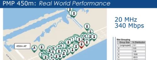

Fast forward 28 months, and cnMedusa is still at the forefront of the fixed wireless space. No other equipment even comes close. 450m has the ability to talk to multiple subscribers simultaneously, thereby multiplying the capacity of the sector, while still maintaining the scalability of connecting over 200 subscribers per sector. Because of the software-defined nature of the 450 platform (built on an FPGA), innovation and advancement of the platform happens nearly continuously, bringing new features, enhancements and performance with every software release. Check out this 2-minute video on 450m real-world field performance.
