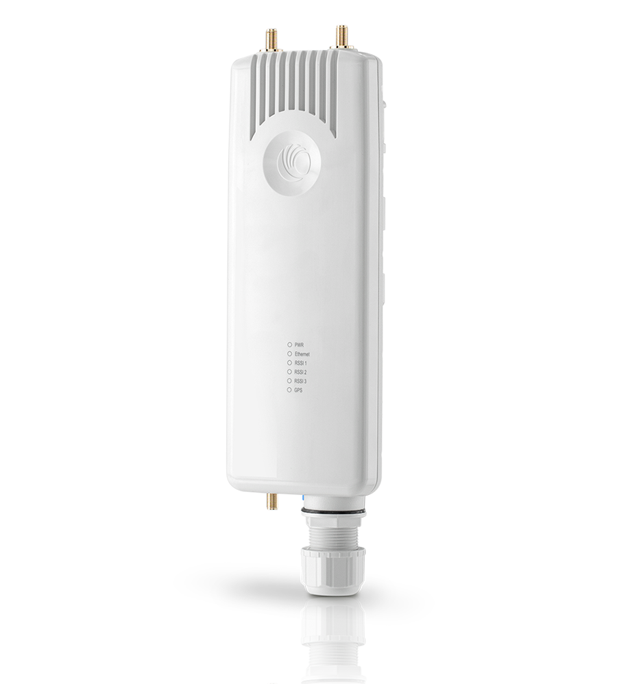

ePMP 3000L
Cambium Networks’ ePMP™ product line has set the standard for high performance, scalability and reliability in harsh interference environments all at a compelling price. The ePMP 3000L is the third generation access point (AP) that carries on the interference tolerance mechanisms with an emphasis on high-performance in low-density point to multipoint sectors.
