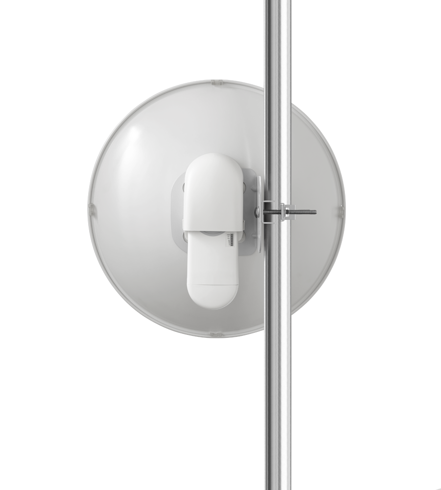

The ePMP™ Force 110 high gain integrated solution enhances range (25 dBi antenna with 30 dBm of transmit power) and improves throughput (up to 150 Mbps of real user data). The Flexible Mode of operation ensures robust adaptivity to both symmetrical and asymmetrical traffic while providing high performance and exceptionally low 6 ms latency. ePMP Force 110 is comprised of ePMP 1000 Connectorized Radio and ePMP 110A-525 Dish.
