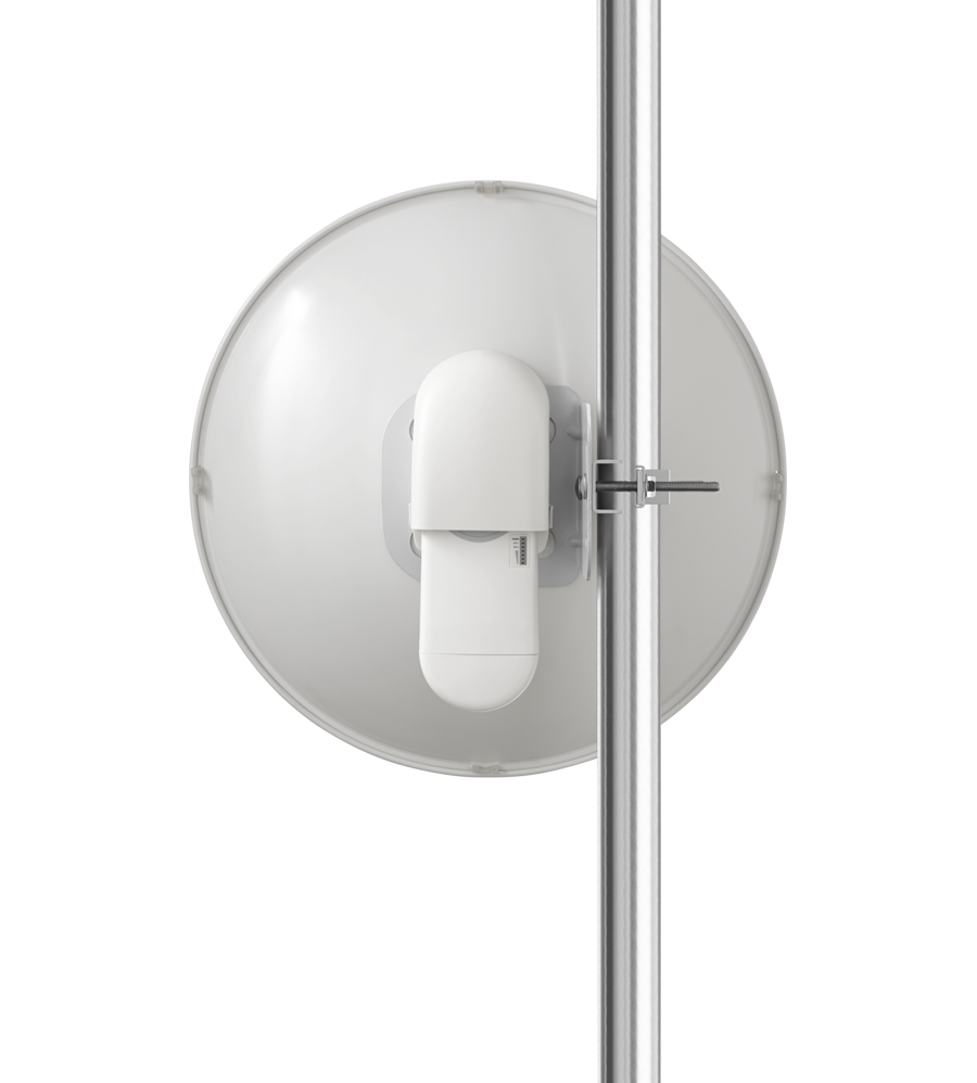

The ePMP™ Force 110 PTP high-gain integrated solution enhances range (25 dBi antenna with 30 dBm of transmit power) and improves throughput (up to 200 Mbps of real-user data). Force 110 PTP achieves 2 ms of round-trip latency and provides an 802.3af-compliant Gigabit Ethernet port. It is composed of the ePMP 1000 Connectorized Synchronized Radio and the ePMP 110A-525 Dish.
